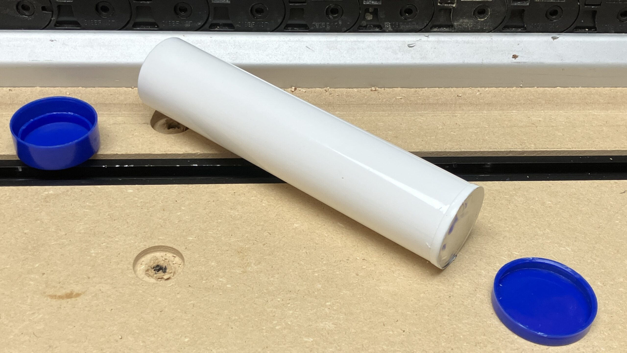

- Mobil EP 2 grease or NLGI #2 lithium grease
- Blunt syringe or pipette, to apply oil
- Grease gun, with an assortment of fittings and at least a 12” length flexible whip hose

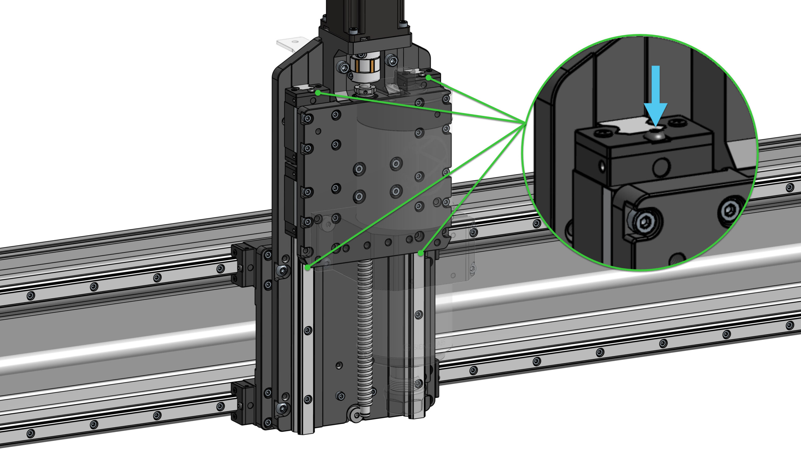

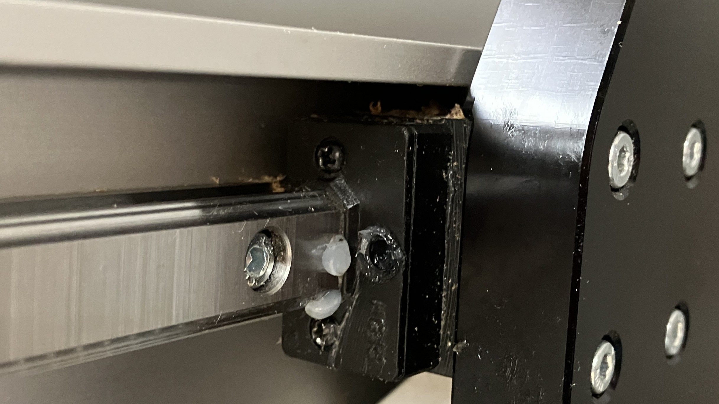

Lubricate – Unfasten the outer button head screw from each linear guide block. Apply the oil using a pipette or syringe to the hole until it flows out. Then refasten the screw. Additionally, you could instead manually coat the linear guide rails with shop towel.
Jog the machine along the axis to distribute the lubricant. Each block should be accessible without disassembly of the machine. The number of blocks on each axis are listed below.
- X-axis: 4
- Y-axis: 2 on each side
- Z-axis: 4

Lubricate – Apply grease at the zerk fitting, using the grease gun. You should only add a small amount, so 1 squeeze at the gun will be enough.
