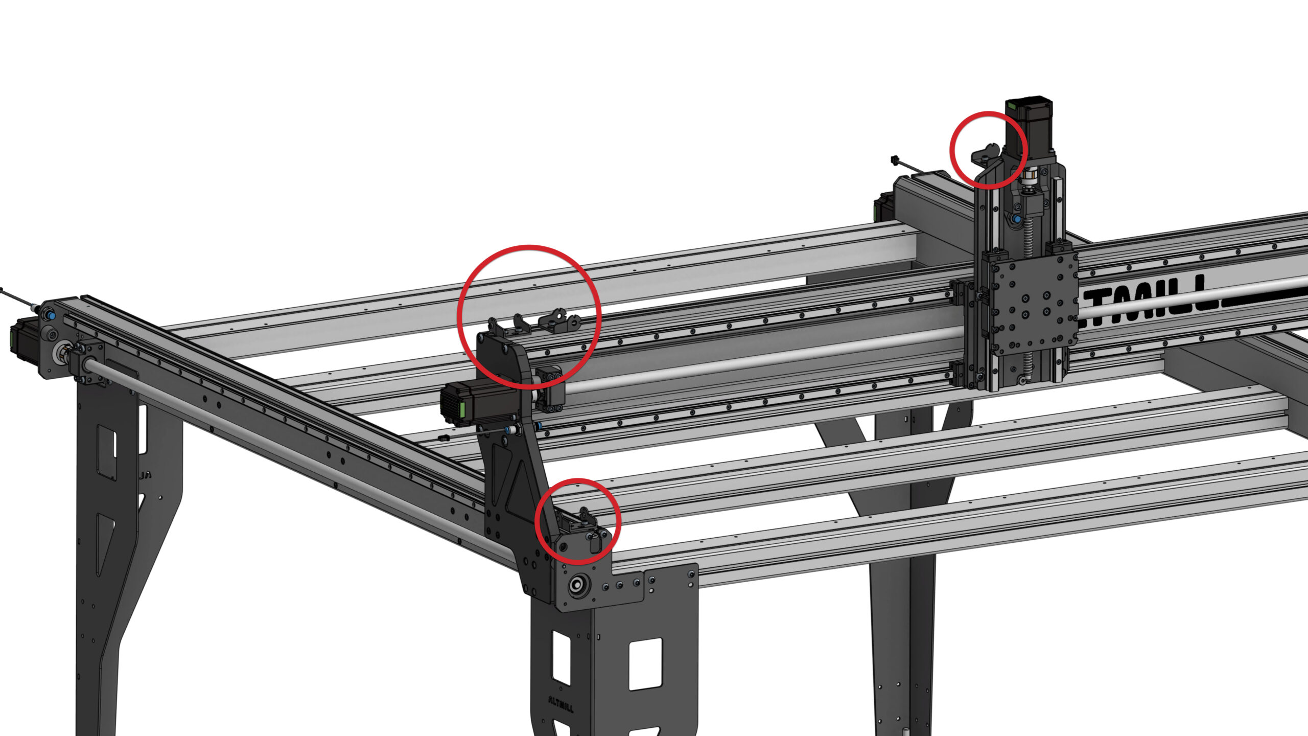

See the image below for locations of drag chain end links, to be attached on the machine.Β
Note: Drag chain end links are in pairs. You will notice one drag chain end link has a flange with holes and the other link has a flange with knobs. It is important you use one of each type for each axis’s drag chain.
General location of drag chain ends on the AltMill
