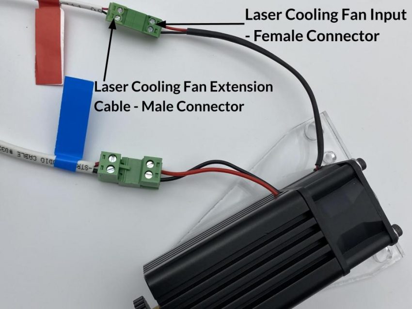

Blue, red and yellow cable connectors next to laser diode assembly
For each connection, make sure that the red wire from the female side meets with the red wire from the male side. Attach the fan connector to the red cable. Attach the diode connector to the blue cable. Make sure not to mix the diode and fan connections!
Red and blue cables connected to cooling fan and diode respectively
Cooling fan and diode connections

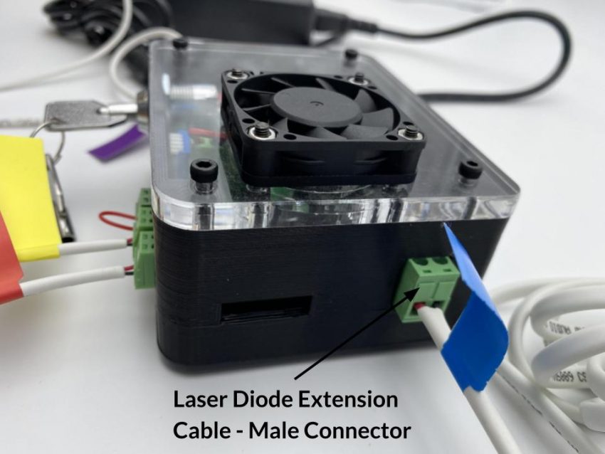

Laser diode → Driver
The laser diode will receive power through the driver. Assuming one end of the blue cable is already plugged into the diode, connect the blue cable to the driver. Make sure that the location of the driver connection is correct as shown.
Laser diode to driver connection

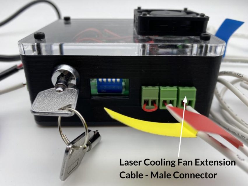

Cooling Fan → Driver
The cooling fan will also receive power through the driver. Assuming one end of the red cable is already plugged to the fan, connect the red cable to the driver. Make sure that the location of the driver connection is correct as shown.
Cooling fan to laser driver connection

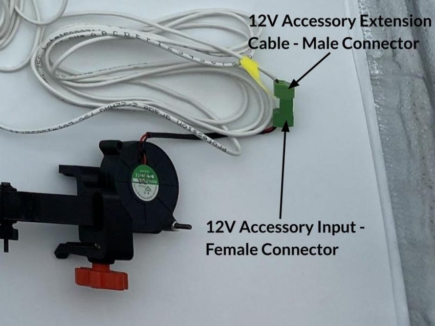

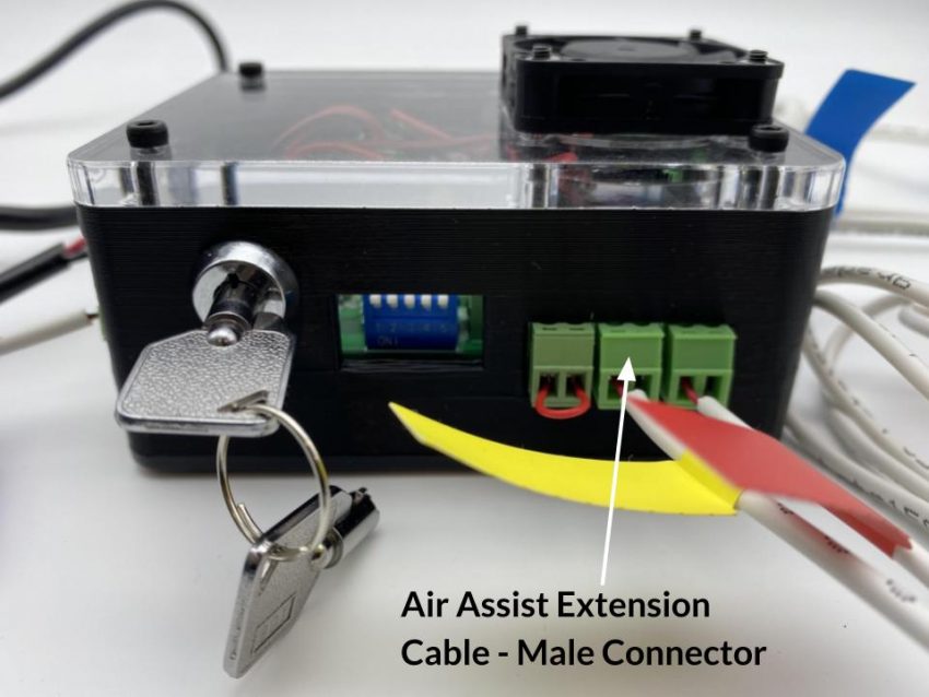

Air Assist → Driver (Optional)
To simplify your building process, we will leave the air assist assembly off the diode. However, we can plug one end of the yellow cable into the driver, leaving the other end free, in case you need to use air assist in the future. Make sure that the location of the driver connection is correct as shown.
Air assist to laser driver connection

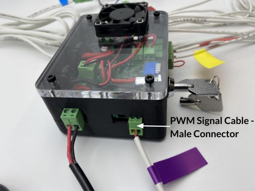

 Driver → Controller
This connection allows you to control your laser through the CNC controller. The driver uses this PWM signal to turn on/off the laser, as well as adjust the intensity and frequency.
On one end, plug in the male connector to the driver’s PWM signal input, at the location shown in the photo.
Connecting PWM signal input to driver

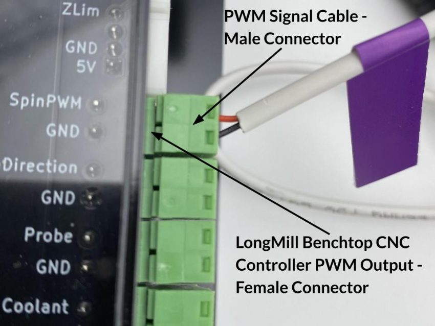

The following steps will vary whether you have the Longboard or the SLB. Please read carefully to ensure you complete the proper steps for your controller.
For the Longboard, plug in one end of the purple cable to the controller, making sure the red wire is seated at the “SpinPWM” and the black wire is seated at “GND.”
Connecting PWM signal input to Longboard
