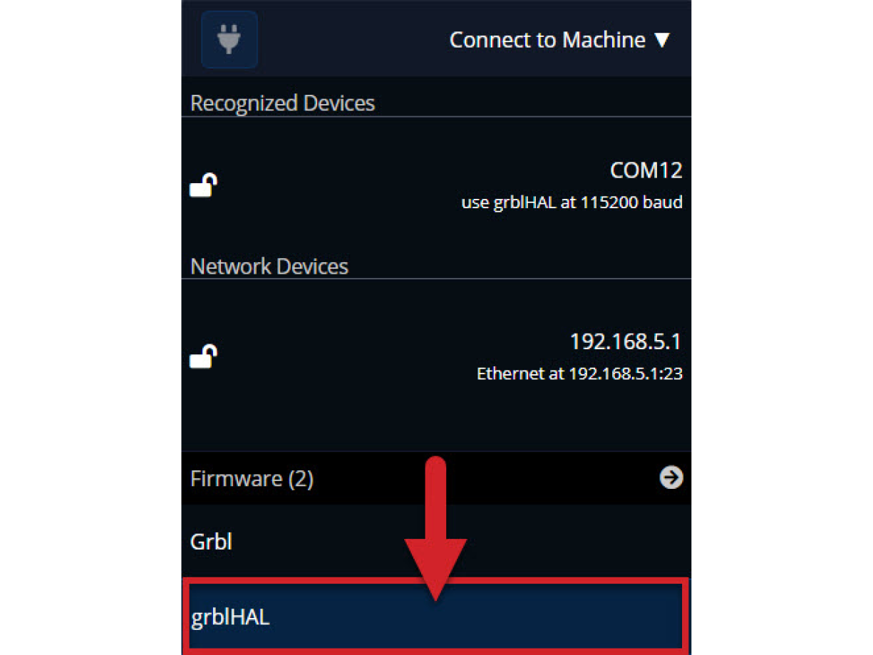

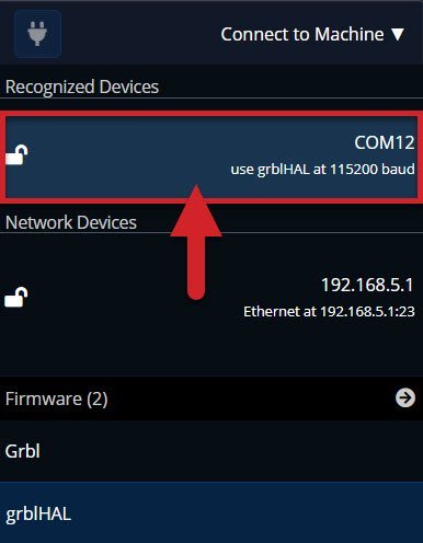

Set Up for SLB or SLB-EXT
SLB or SLB-EXT:
On gSender, connect to your machine.
Click the gray bar at the bottom labelled “Firmware.” Then click on grblHAL.
Hover over the top of the menu. Under “Recognized Devices” there should be only one option that says use grblHAL at 115200 baud, so let’s select that.
