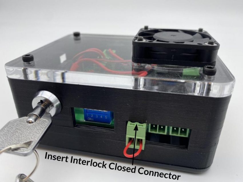

1. Ensure the power supply is getting power and the interlock connector is secure.
Power supply indicator
Interlock connector on

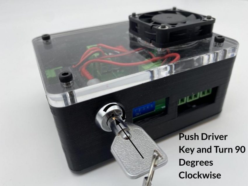

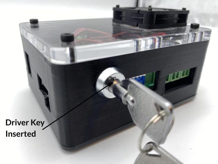

2. Insert the driver key into the key switch, then push and turn the key 90 degrees clockwise

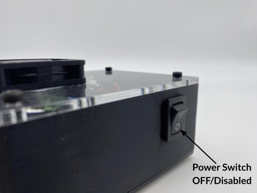

4. Flip the power switch ON (“1” position)

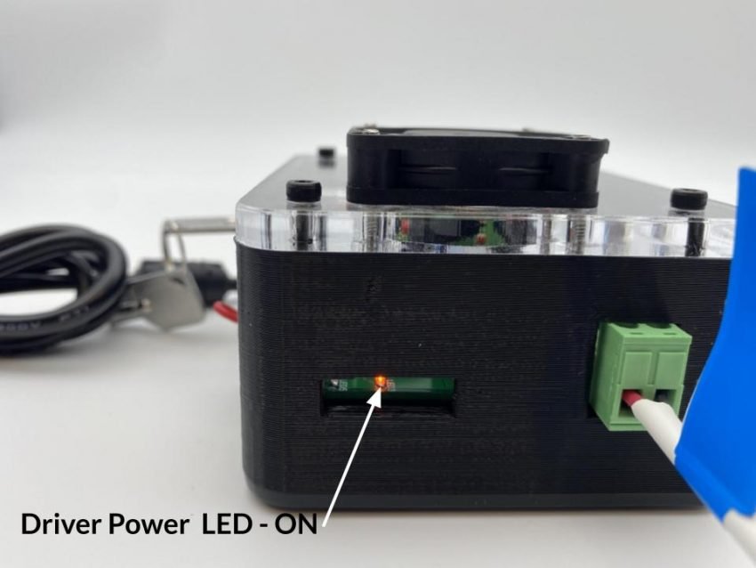

You should hear a fan sound, with 1 red LED lighting up in your driver. If none of this happens, there may be a wiring mistake.
Top view of driver power LED on
Side view of driver power LED on

Interlock
If you are looking to install a different switch, you need to make sure it is a normally closed (NC) switch in order to enable driver functionality. Simply replace the interlock connector with your switch of choice.

There are two LED indicators to know. The first is the driver power LED, which will be on when you successfully turn on your driver.
Driver power LED on
