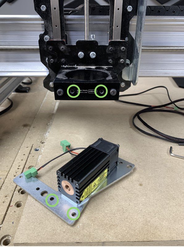

1. Begin by using an appropiate allen key to remove the 4 M3 bolts circled in the picture below from your standard LaserBeam Mount:
2. Grab your Vortex Riser Mount and align the circled mounting holes with those of the LaserBeam diode:
3. Grab the M3 bolts you removed in step 1. Insert them into the aligned mounting holes and hand tighten. From there use your allen key to the tighten them fully:

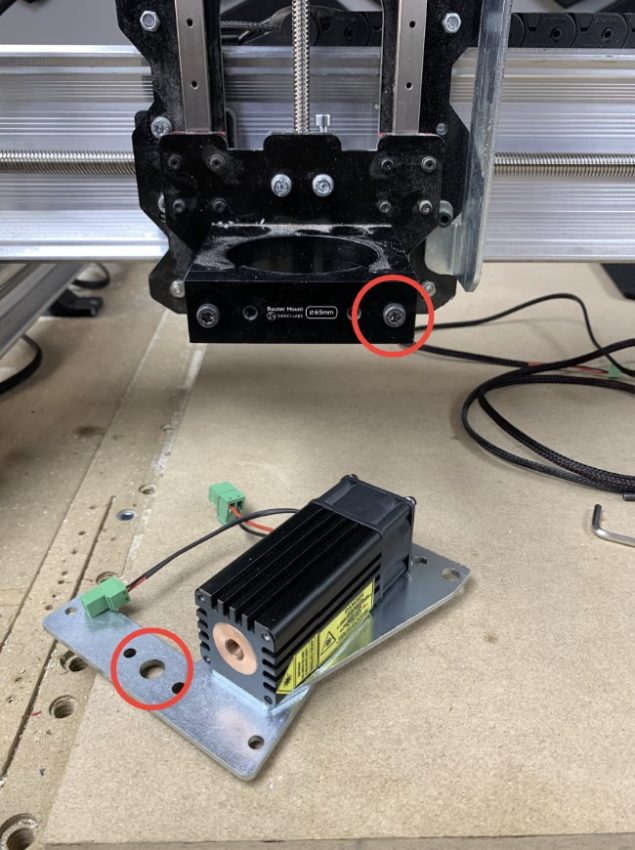

1. Firstly, use an appropiate allen key to remove the circled M5 bolts from your router mount:
2. Line up the circled holes with the location of the removed bolts:
3. Re-insert the M5 bolts previously removed in step 1 and tighten them with your allen key:

1. Like with orientation one, we firstly want use an appropiate allen key to remove the circled M5 bolts from your router mount.
2. Now we want to losen the side bolt. We loosen it until the circled mounting hole on the Vortex Riser is able to slide past it and become flush with the router mount face:
3. Align the mounting holes and re-insert the previously removed M5 bolts:
4. Tighten the bolts with your allen key to complete the attachement:
